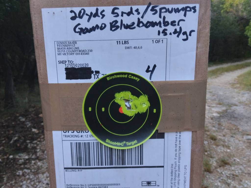

Then decided to have some fun with some new targets I printed out. In this instance, 9 shots with the scope to the "head" and 9 with the iron sights. Iron sights shoot a little high right now, but can't complain about grouping! (The three off-center shots were bad trigger control.) I had to make my own mounting rail for the iron sights but so far, can't complain about the results!

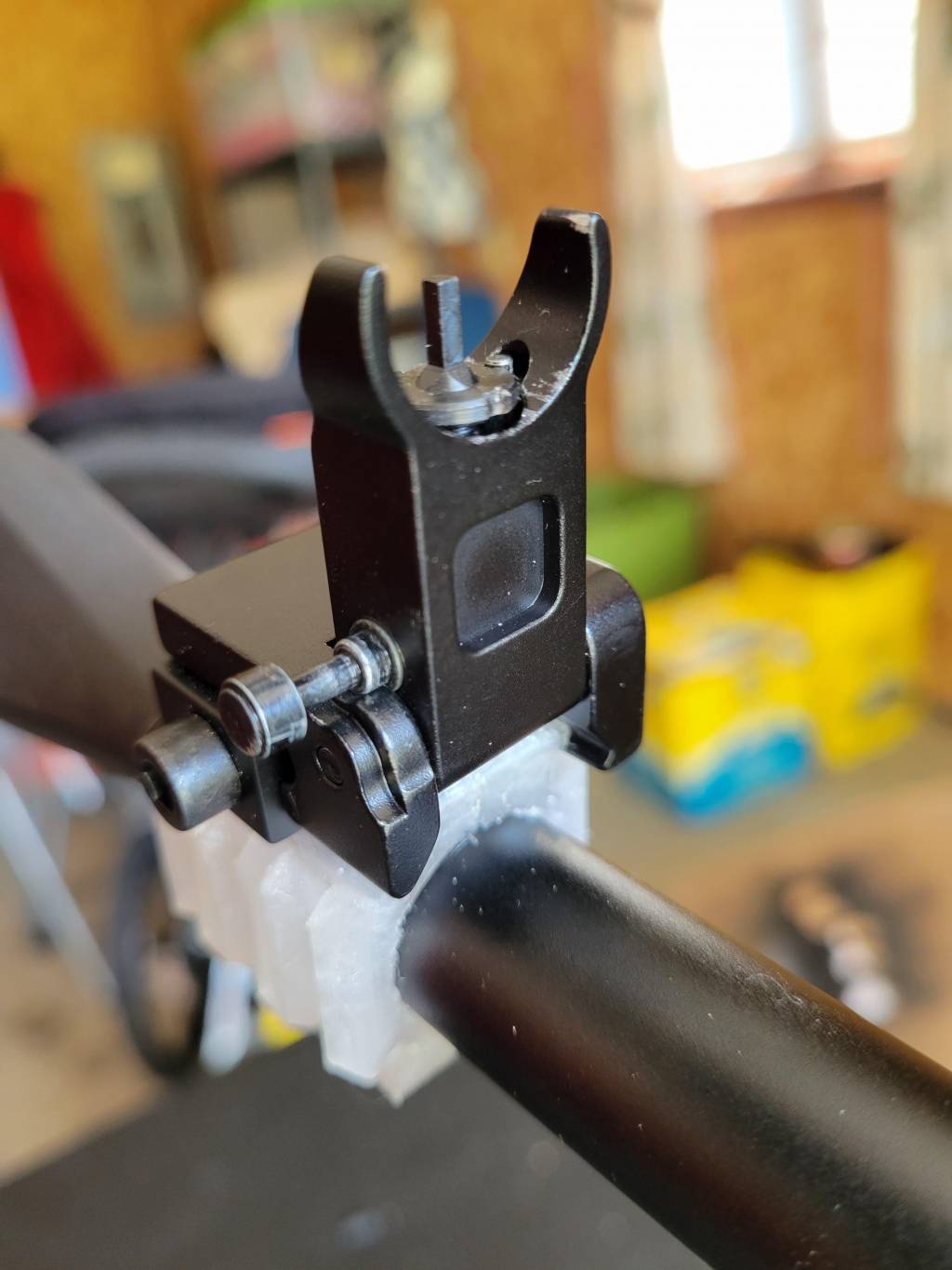

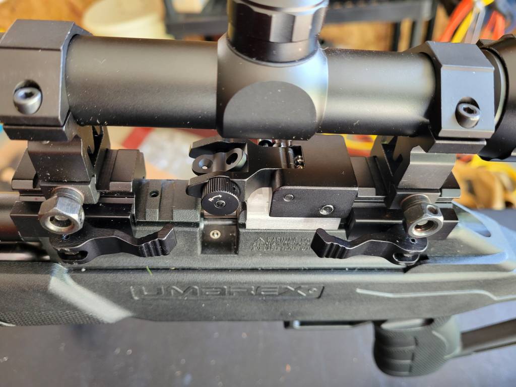

I'm working on mounting some iron sights to my Fusion 2. Its trial and error. The hard part is finding a good front mount because of the integrated suppressor. I have to use a 3D printed picatinny mount on the barrel with AR style sights. The problem I keep running into is just getting things setup just right so I still use the scope with a quick mount. Yes, a scope is more accurate, but sometimes, I just want to plink away without one.
Right now, I'm using a set of cheap flip-up sights with a quick detach for my scope. My first iteration didn't work because I had the scope mounted too far back, mainly because of how the mounting rail and magazine interact. I just got my latest version mocked up yesterday, but then my front sight adjustment tool snapped on me. GAHHH! The reason it snapped is because I had to replace the front post and the replacement was threading in a little too tight. Now I'm waiting on a replacement sight tool with a tap/die set to arrive so I can finally test it out.
