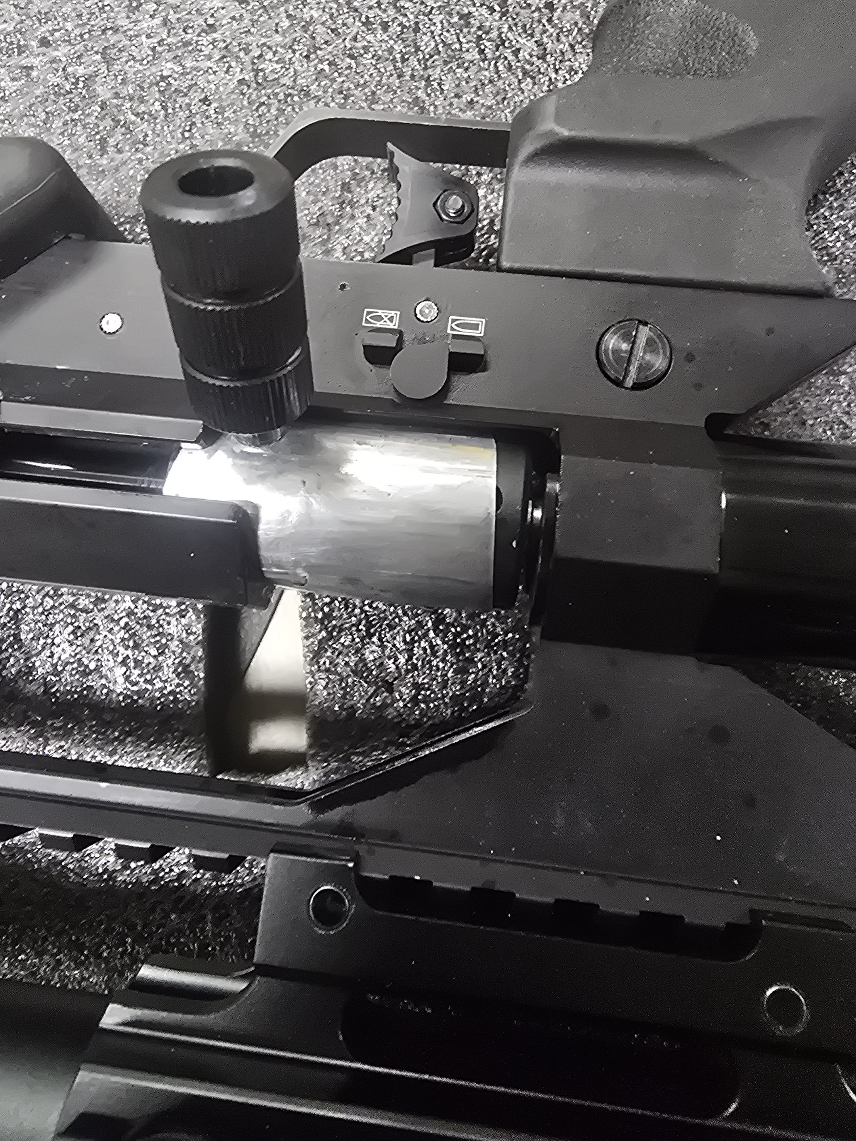

Received the P-RIFLE today. No damage to box or rifle. Aired up and shot 10 shots with 14.3 averaging 904 fps and 21.6 fpe. Had a high of 911 and 1st shot was low at 895 fps. Came with 2 mags and o rings. The mags load into breech from the lt side but the BARRA 1100Z mags fit perfect and load in from rt side. I think the BARRA mags will fit the P-PUP also. Both are 10 shot and BARRA has them at $12.00 each. First impression is it is light weight shoulders well and cocking is a little heavy. trigger feels great right out of box. Has been sitting for 4 hours with no loss of pressure. Right now I have the flu but hopefully by the weekend will do some testing.

UPDATE
Just tried the .22 Beeman magazines.
They do not fit the bullpup.

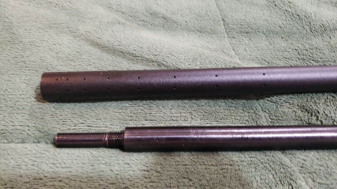

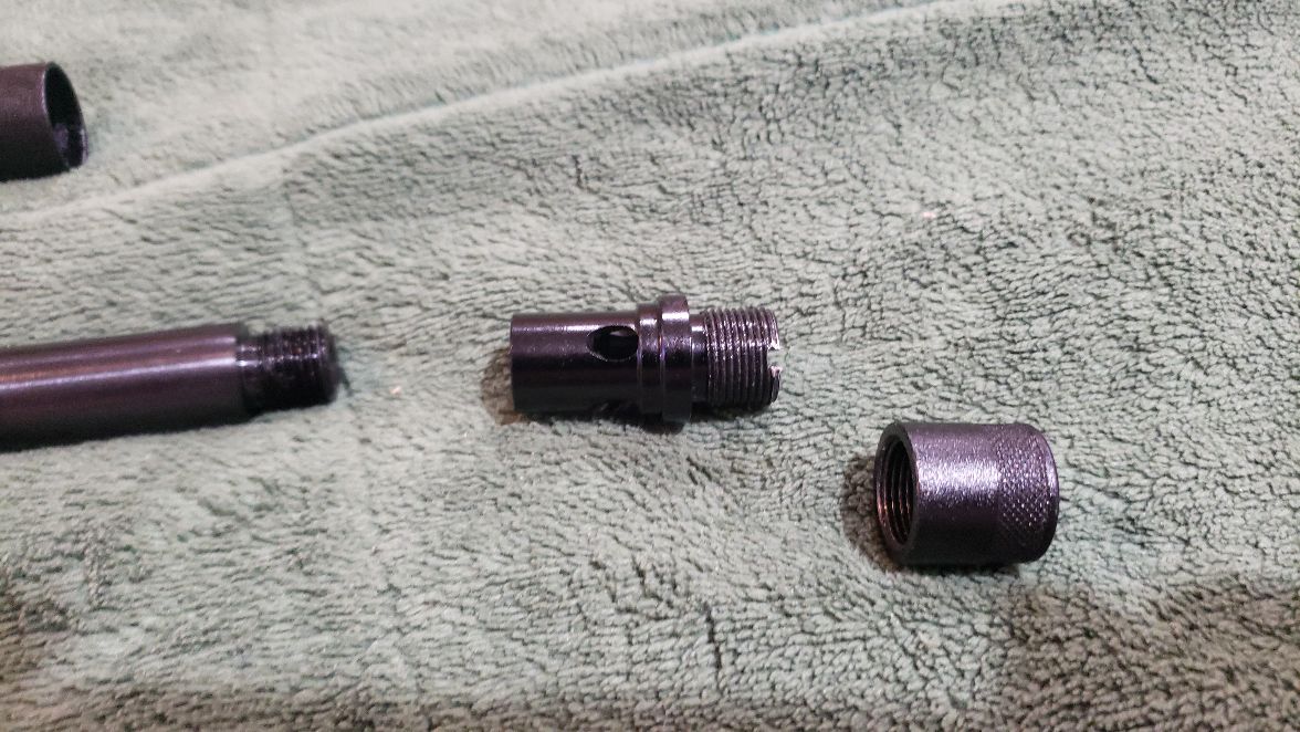

Been in bed with flu only shot 1 mag. Barrel is tensioned on with an adaptor holding an empty carbon shroud with holes in it. The adaptor is threaded 14 x 1 just like my P-FORCE. The mod on my P-FORCE fits nicely and quiets it down. Seems not too loud but do not have a meter. I read BUCKRAIL has mods but I looked and nothing in 14 x 1 only 14 x 1.25 threads. Also barrel is screwed into breech and has I believe -will check later- barrel has 1/2 x 20 threads. Hopefully this weekend will be up to testing.
Here is rifle barrel off. The DFL TANTO 1/2 X 20N SCREWS OINTO END OF BARREL BUT NOT ADAPTOR.

few more questions on the ID clearance between the barrel and shroud
Just to clarify are both ends of the barrel 1/2 x 20 with the adaptor being 14 x 1 thread size ?
with this having a 18.1" barrel, how much of it is screwed into the receiver ?
