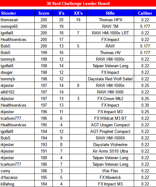

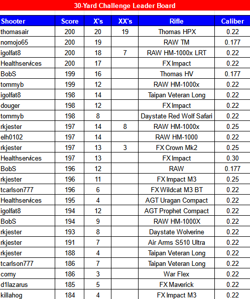

Updated Leaderboard:
Holy smokes Mike. I’m pretty sure that card moves you to the top with a 200, 20X? Congrats on great shooting!
Hey Tom C…
Did you forget to add Mike’s 200-20X card to the Leaderboard?
Mike N - spectacular! It doesn’t appear that the mild wind impeded your efforts, especially with no rest. Glad to see this challenge is attracting other BR shooters.

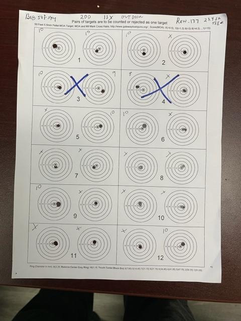

I shot this morning with my RAW.177 - Looking at the posts I'm not sure if I'm scoring correctly. Someone please let me know. I have been using a 22 plug but today I used a 22 jsp rd. I pushed the head in the hole to center it and wherever the skirt ended up touching gave me my score. ie If it touched the grey line it was a 10 if it touch the black it was an X. I think the skirts are a little more forgiving than the plug - maybe a little more diameter. I shot outside at 27.34 yds (25m) - If I'm scoring correctly then it was a 200 w/ 13 X' - but again I'm not sure how to score with a pellet skirt so correct me if I'm wrong. Thanks, Bob

Allen,
I wouldn’t say it’s easy…but it is within the range of achievable with my equipment and wind reading ability at this particular distance. After initially looking at the card, I was relatively sure I could shoot a 200 20x if the wind was light. I shoot well over 100,000 shots per year over my wind flags outdoors….and have been doing this for many years. I can narrow down wind strength to around 1 mph or less if the wind is under 4-5 mph based on the angle of my wind flag tails. At this distance that puts my lateral wind reading error to probably around .070” with the pellets I used. My rifle will reliably shoot a round group of about .125” ctc for 25 shots at 30y. That means if the group size and wind error are at their worst….I can be up to almost .140” away from center. That is still going to give you an X. Sometimes the group size and your wind error will combine to give you a perfect shot even though you actually did not read the wind perfectly. I’m a numbers kind of person and every shot is a calculation for me. I’m always trying to figure the absolute least amount the wind may move my pellet and the absolute greatest and then hedge my bet to maximize my odds of catching the ten (or x on this card). I don’t care about trying for the center. If they go there, great….but it’s just as good to be off center just enough to catch the x. The distance from catching the x on one side and catching it on the other is your margin of wind error minus 1/2 your average group size of however many shots the card is. Once the wind speed gets over about 5….my wind velocity estimate error will increase quite a bit. 2-3 mph is the sweet spot. There is a lot more to it than that, but just knowing exactly what you have to work with is very helpful in making wind decisions that will maximize your percentage. Trying for the center will always yield more misses for me.
Not easy….but doable at this distance.
Mike
As I mentioned before….The guys that shot the 200s with the .177 20fpe guns had to estimate the wind hold with twice as much precision. That’s much harder.
