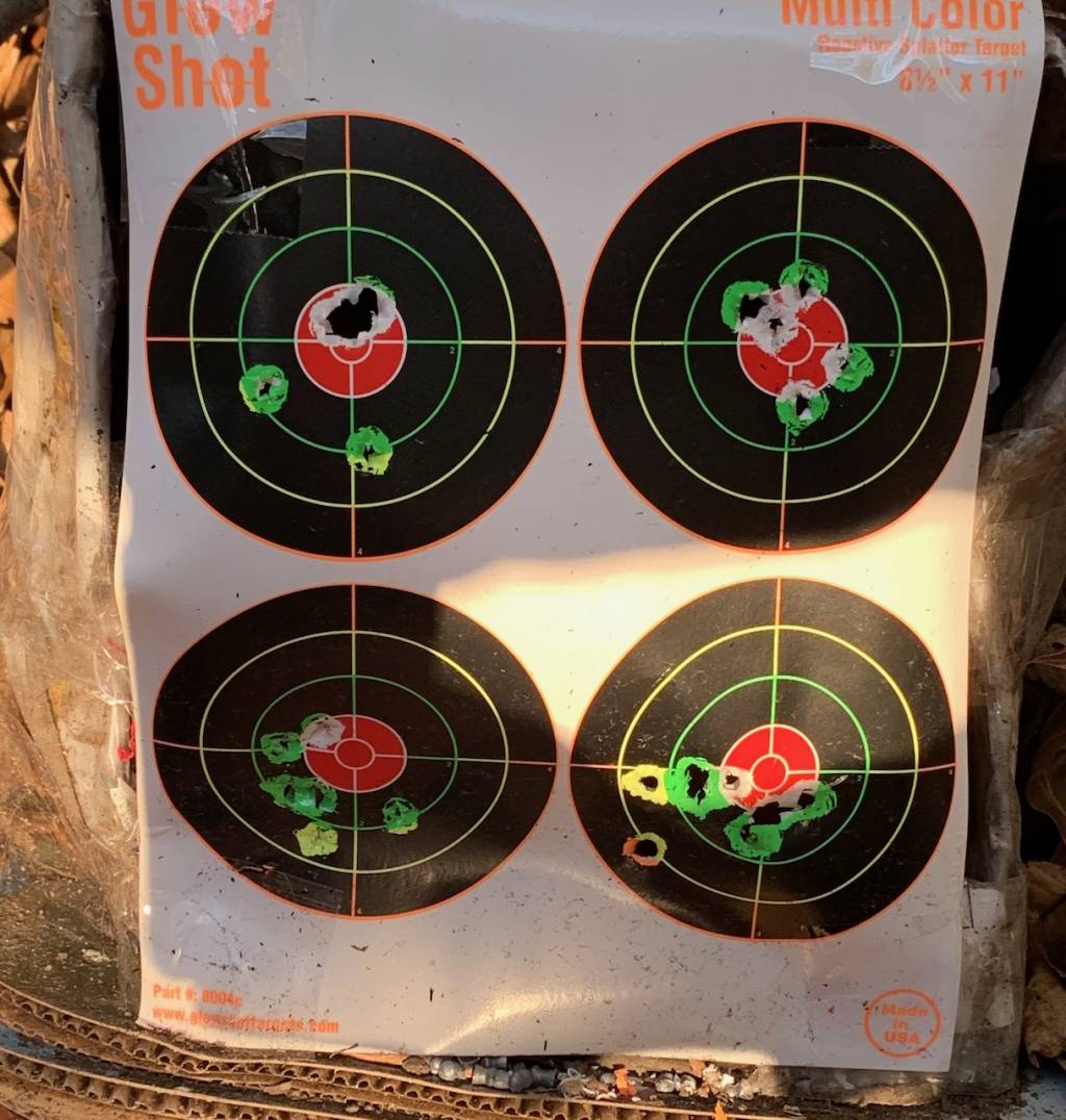

Some target shooting and a comparison of .22 250mm vs 350mm barrels. I've found one of the best pellets for my L2 is the H&N Barracuda Match 21gr in 5.51mm head size.
The bottom two targets are with the 250mm barrel (shooting ~720fps). The top two are the 350mm barrel (shooting ~890fps). Distance 46 yards.
Note - I've never had an airgun that can push the H&N 21gr this fast. These things are cooking around 38fpe and the L2 isn't breaking a sweat.
As you can see the 250mm barrel couldn't hold a tight group. The 350mm barrel has tightened things up. Top left is 8 shots - two fell low, but those 6 in a hole made me smile. Top right is another 8 shots. Nothing fancy for setup, shooting prone off the kitchen floor and out the slider door, bipod in front, shoulder supporting the butt.

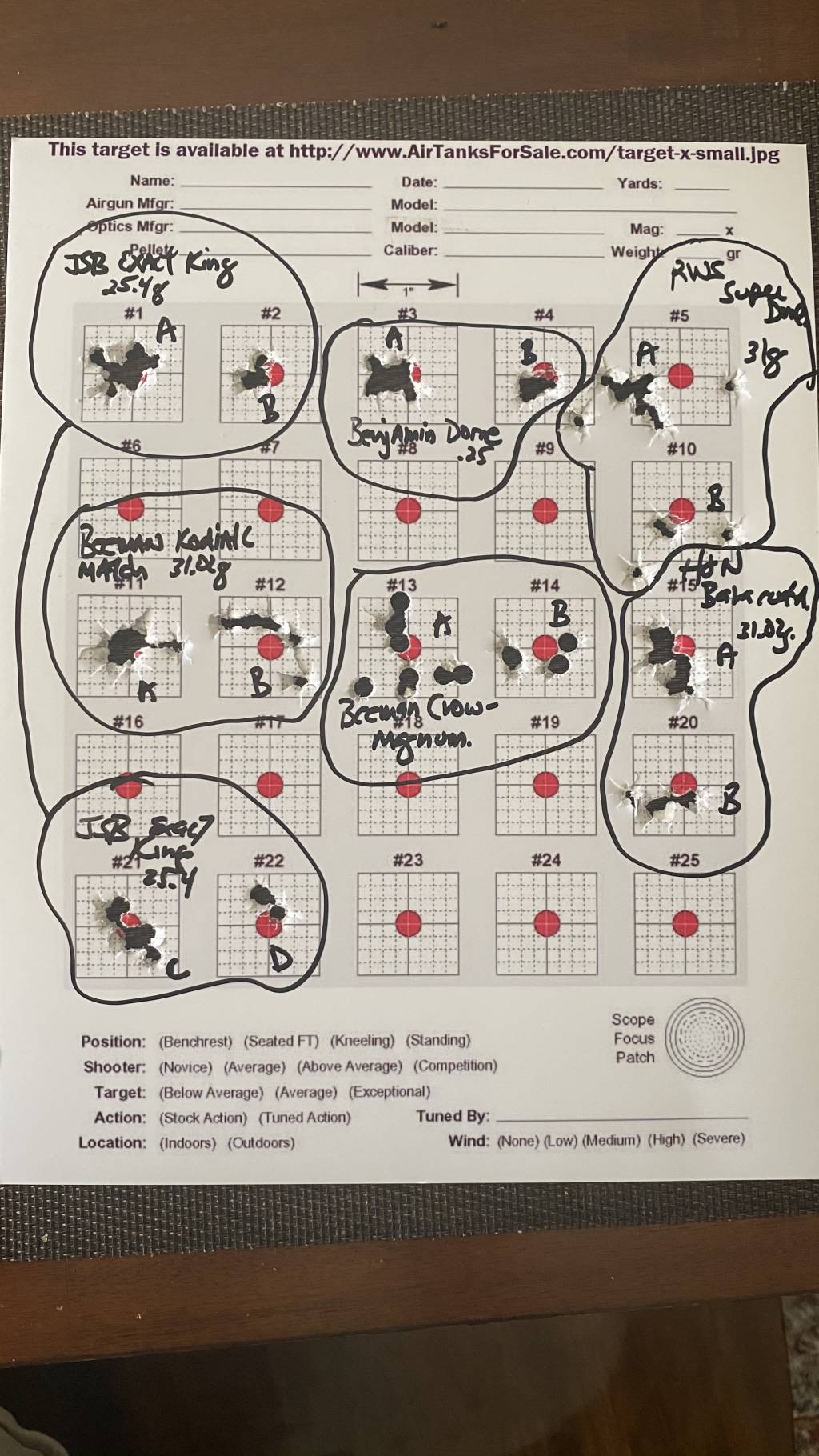

Had a little time this afternoon to answer my own question regarding which pellets shoot well out of the Leshiy 2 350mm .25 cal.
the photo above is a target printed on photo paper from Joe B off his site.
Bipod and a shooting bench was used at 28 yards (This is the max allow in my back yard)
Each numbered square is one inch.
A is first shot group of 8 shots, B is second shot group of 4 shots (tried to take it a little slower between shots to concentrate).
JSB Exact Kings .25 25.4gr box #1 and #2 A group was not bad, B group was better, took a little more time to aim and more careful not to jerk the trigger.
Benjamin Dome 27.8gr Box #3 and #4 A group was surprised that these cheap pellets for my old marauder did so well. B group just as good.
RWS Super Dome 31gr Box #5 and #10 A group was good except two that just went left and right. B better ,but all over.
Beeman Kodiac Match 31.0gr Box #11 and #12 A group was simlar to the JSB's but I dont know what happed in B group, still fair
Beeman Crow-Magnum ? gr Box #13 and #14 A group was all over the place, B group was a little better (these are big and heavy pellets with hollow pointed)
H & N Baracuda 31.0gr Box #15 and #20 A group performed just behind the JSB and Beeman Kodiak Match. B group had one shot off.
Box #21 and #22 was just repeats of my basic standard JSB's Performance consistent.
Im not a great shot, but these are the result I got with a little testing, the Eunjin .25 35.8gr flat head pellets by air venturi and the .25 43.2gr pointed head pellets would not fit into the magazine.
