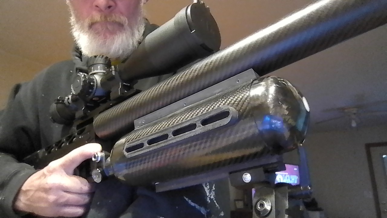

i made this for mine to add a tripod grip or whatever with mloc
