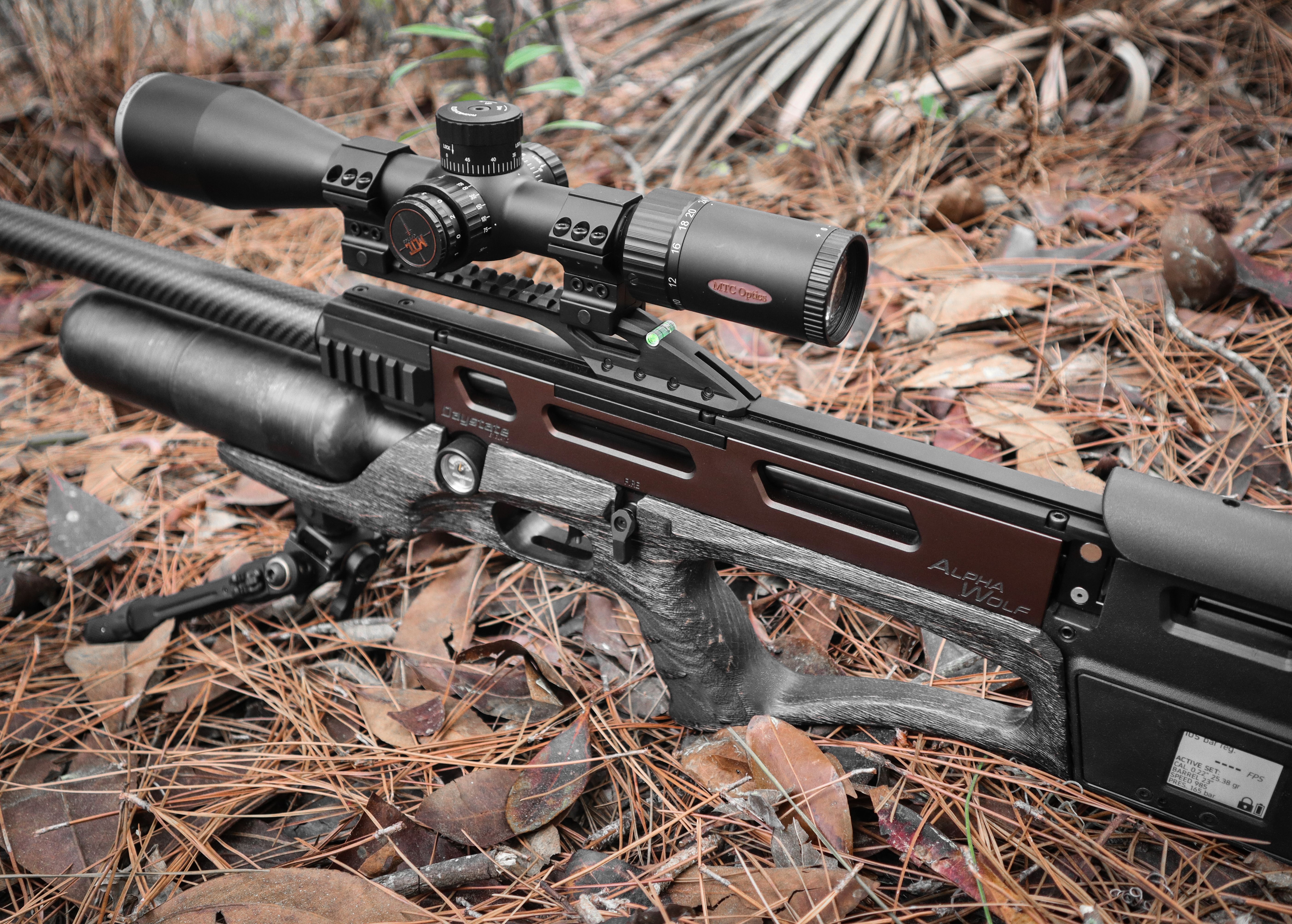

The NEW Daystate Alpha Wolf Safari Edition!

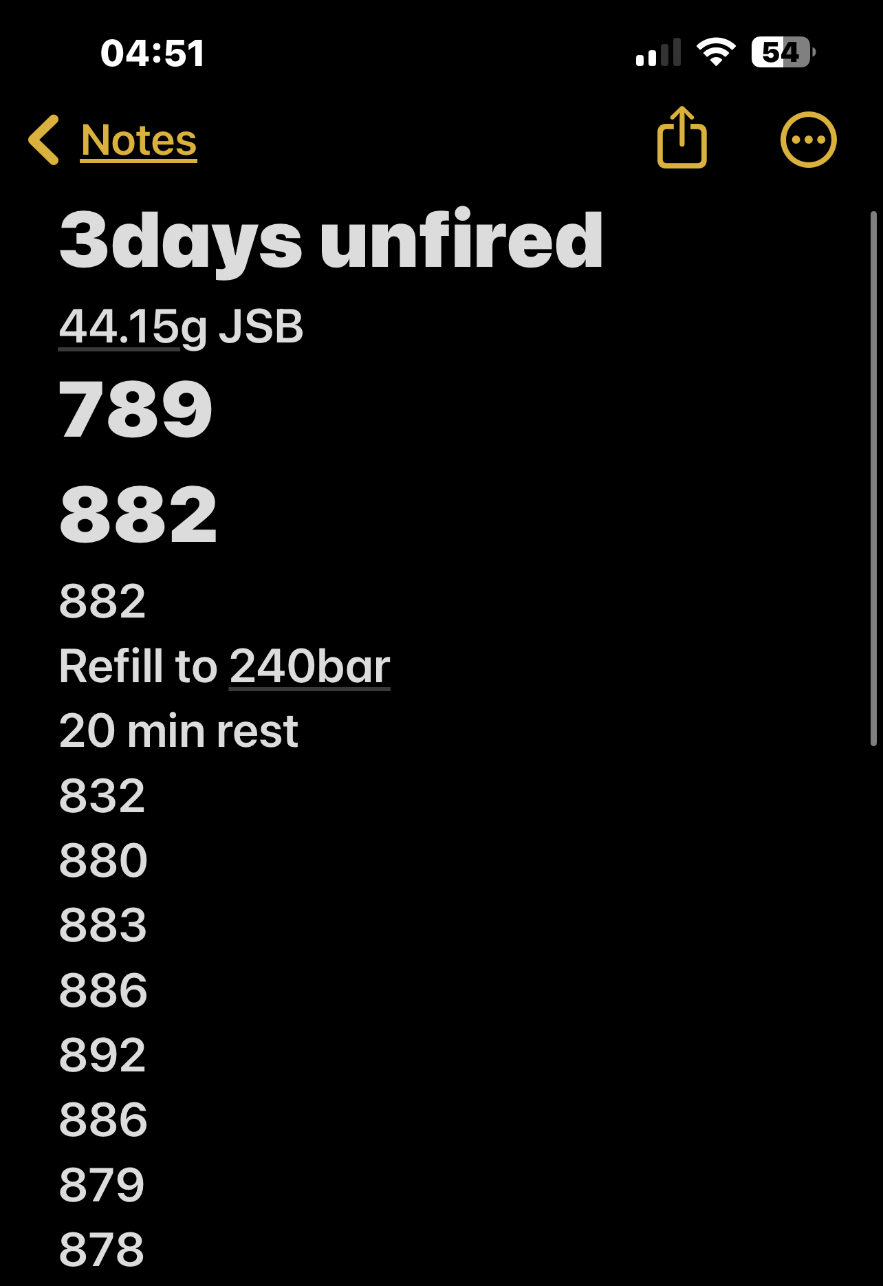

I received my 30 cal Alpha Wolf Safari week before last. I’m waiting on AOA to get things straightened out now. Check your first shot on the feet per second. If I let my gun sit for more than 10 minutes then it’s 50 feet a second slower than the consecutive shots after that. If I let the gun sit for a couple days it’s 100 feet a second slower on the first shot and the bottle does not leak.
Not very happy at the moment.. I’m no paper puncher, Varmint hunter so that first shot has to be money. It’s mechanical I’m sure it can be fixed but pretty disappointing right now.

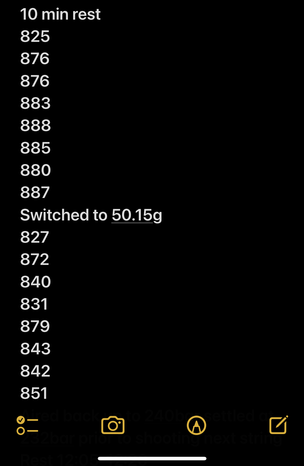

I’ve read about something similar happening to others. Question. If you shoot 5 or more consecutive shots, does the speed go back up? And, are you running in the factory shot mode or advanced mode? Regardless, I agree that speed drop shouldn’t happen but I’m curious if it’s a computer issue.

Speed goes back up after first shot. I have not played with the setting. AOA set the gun to advanced setting “3040”. Here are screen shots of test I have ran.

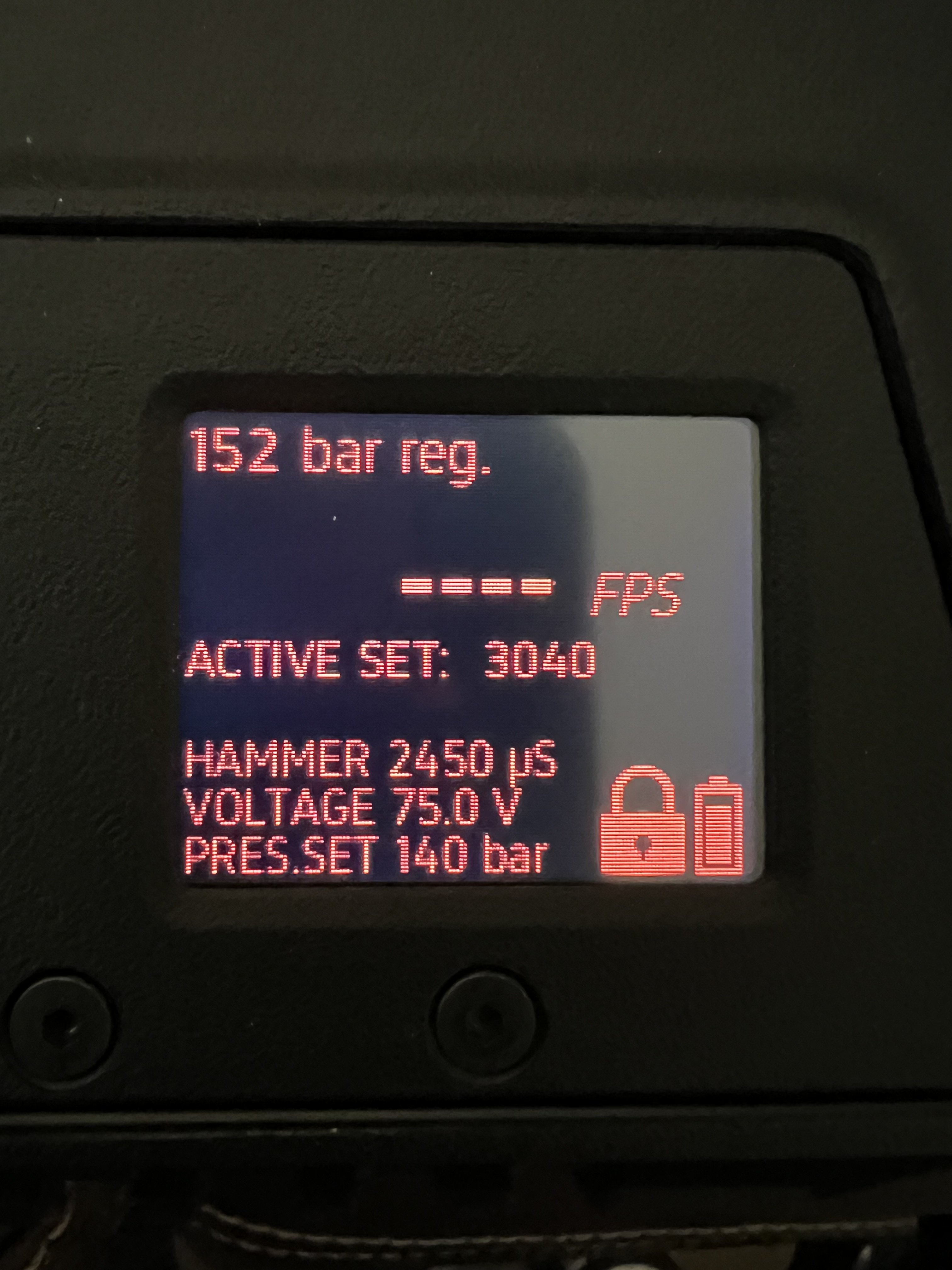

Check your Safari for reg creep by looking at the reg pressure after you take your last 'good' shot. 10 minutes later check to see what the reg pressure is on the display. Also check your reg pressure after sitting overnight. I had a reg that was creeping between 5-10bar overnight. AoA sent me a new one and it's better, but there is still creep.
EDIT 2: You can mostly ignore the "Pressure Set" as that will not impact your speed consistency. It's part of the programming and it's the pressure the reg is at when the program is set in the airgun. I would, though, drop your reg as it appears to be settling a bit high and that program may work best at 140 bar.

I tried after sleep mode and keeping gun active and it made no difference if it sat for 10 mins or more 1st shot was low.
Picture above shows reg pressure after shots. Gun shows it’s set to 140. It goes up to 152 after a few minutes of no use. Stays at 152 over night
